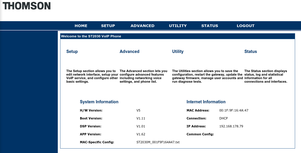

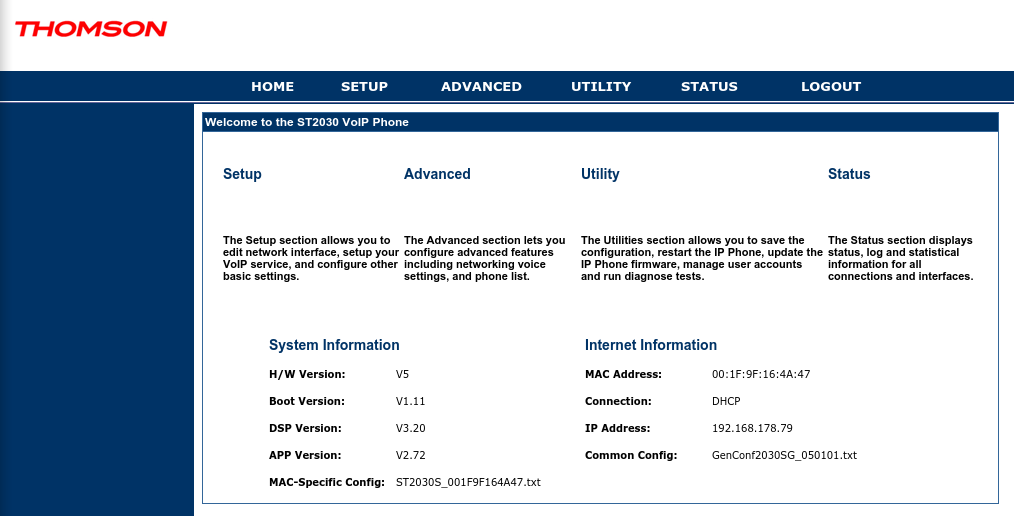

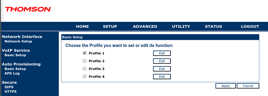

Screenshots Webinterface
Bis Version V2.66
Ab Version V2.68

Thomson ST2030 Menüführung
Posted: Mon 19. Dec 2016, 21:13

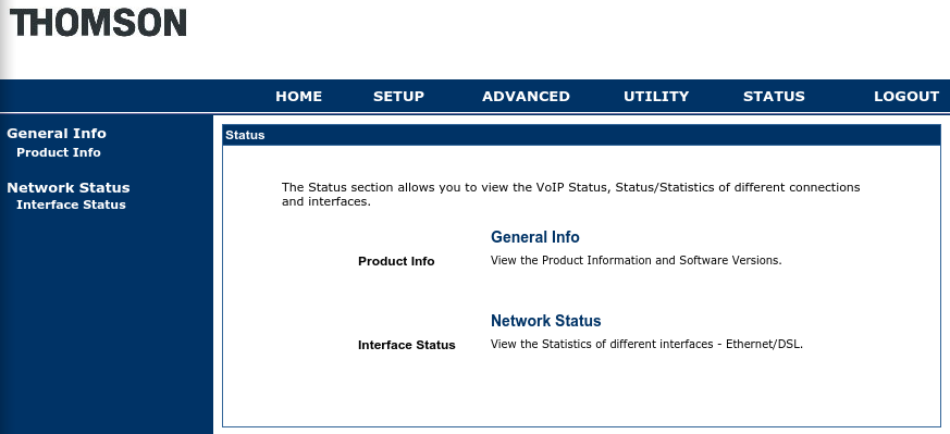

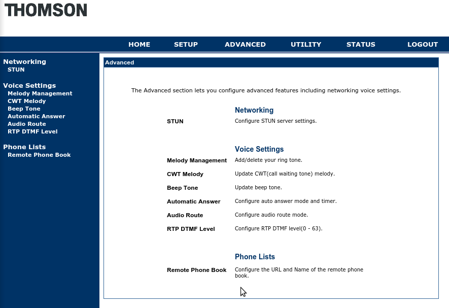

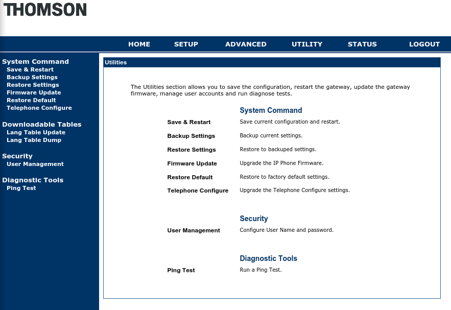

Ich habe aus einer Insolvenzauflösung unzählige Thomson ST2030 VoIP Telefon erstanden welche auch mit der richtigen Firmware SIP fähig sind.
Leider zerschießt es bei fortschreitender Firmware das Menü (zumindest bei mir) weshalb ich mir eine Linkliste von einem Intaktem Menü erstellt habe:

ADVANCED
Networking - STUN
http://ip_adresse_des_telefons/advanced_stun.html
Networking - UPnP
http://ip_adresse_des_telefons/advanced_upnp.html
Networking - SNTP
http://ip_adresse_des_telefons/advanced_sntp.html
Networking - SNMP
http://ip_adresse_des_telefons/advanced_snmp.html
Networking - QoS
http://ip_adresse_des_telefons/advanced_qos.html
Networking - Ethernet Connection
http://ip_adresse_des_telefons/setup_ethernet_config.html
Networking - Outbound Proxy
http://ip_adresse_des_telefons/advanced_outbound_proxy.html
Voice Settings - SIP Signalling
http://ip_adresse_des_telefons/advanced_signalling.html
Voice Settings - Codec Setup
http://ip_adresse_des_telefons/advanced_codec_setup.html
Voice Settings - Option Configure
http://ip_adresse_des_telefons/option_config_setting.html
Voice Settings - Call Feature
http://ip_adresse_des_telefons/advanced_call_features.html
Voice Settings - Advanced
http://ip_adresse_des_telefons/advanced_advanced.html
Voice Settings - Service Code
http://ip_adresse_des_telefons/advanced_service_code.html
Voice Settings - Dial Plan
http://ip_adresse_des_telefons/advanced_dialplan.html
Voice Settings - Melody Management
http://ip_adresse_des_telefons/advanced_melody_manage.html
Voice Settings - CWT Melody
http://ip_adresse_des_telefons/advanced_callwaiting_tone.html
Voice Settings - Beep Tone
http://ip_adresse_des_telefons/advanced_beep_tone.html
Voice Settings - Automatic Answer
http://ip_adresse_des_telefons/advanced_auto_answer.html
Voice Settings - Audio Route
http://ip_adresse_des_telefons/advanced_audio_route.html
Voice Settings - RTP DTMF Level
http://ip_adresse_des_telefons/advanced_rtp_dtmf.html
Phone Lists - Remote Phone Book
http://ip_adresse_des_telefons/advanced_remote_phonebook.html
UTILITY
System Command - Save & Restart
http://ip_adresse_des_telefons/restart.html
System Command - Backup Settings
http://ip_adresse_des_telefons/utility_ffs_backup.html
System Command - Restore Settings
http://ip_adresse_des_telefons/utility_ffs_restore.html
System Command - Firmware Update
http://ip_adresse_des_telefons/utility_swupdate_http.html
System Command - Restore Default
http://ip_adresse_des_telefons/utility_reset_default.html
System Command - Telephone Configure
http://ip_adresse_des_telefons/utility_telcfg_http.html
Downloadable Tables - Lang Table Update
http://ip_adresse_des_telefons/utility_language_http.html
Downloadable Tables - Lang Table Dump
http://ip_adresse_des_telefons/utility_lang_http_dump.html
Downloadable Tables - Tone Table Update
http://ip_adresse_des_telefons/utility_tone_http.html
Downloadable Tables - Tone Table Dump
http://ip_adresse_des_telefons/utility_tone_http_dump.html
Security - User Management
http://ip_adresse_des_telefons/utility_account.html
Security - PIN Setting
http://ip_adresse_des_telefons/utility_pin_setting.html
Security - Phone Lock
http://ip_adresse_des_telefons/utility_phonelock.html
Diagnostic Tools - Ping Test
http://ip_adresse_des_telefons/utility_ping_test.html

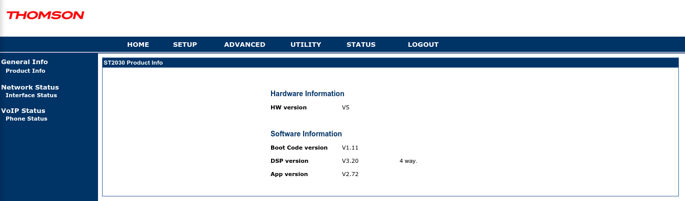

STATUS
General Info - Product Info
http://ip_adresse_des_telefons/status_product_info.html
Network Status - Interface Status
http://ip_adresse_des_telefons/status_interface.html
VoIP Status - Phone Status
http://ip_adresse_des_telefons/status_phone_reg.html
